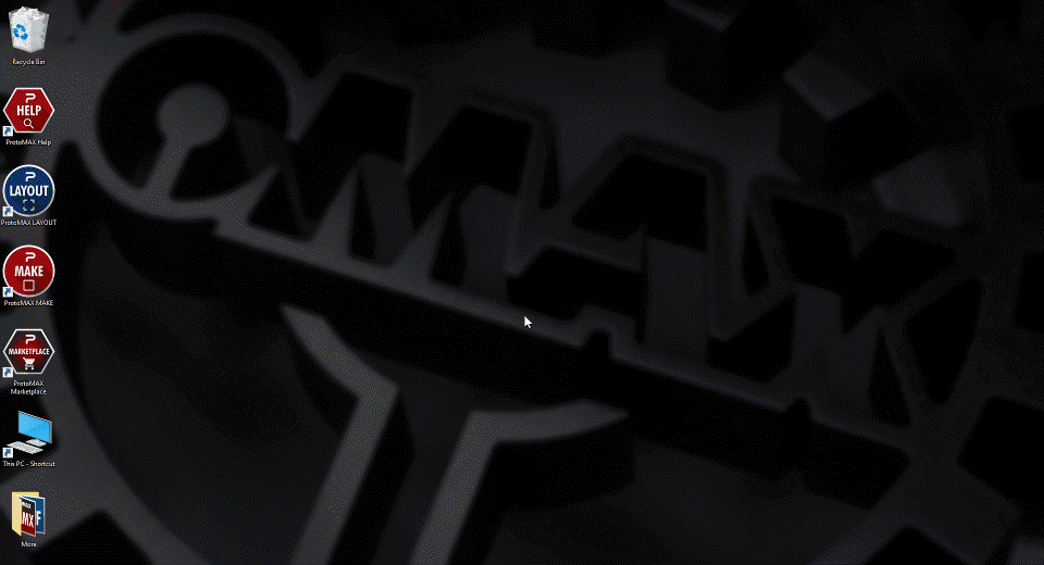

Welcome to ProtoMAX®
This software consists of:
ProtoMAX LAYOUT:
Computer Aided Design / Computer Aided Manufacturing (CAD/CAM) software.  LAYOUT is used to:
    • Import and convert files from other drawing systems
    • Edit or draw new parts from scratch
    • Create tool paths (OMX files)
ProtoMAX MAKE:
The controller for the machine.  MAKE is used to:
    • Test and simulate tool paths
    • Position the cutting tool
    • Run tool paths to do the cutting
LAYOUT can be replaced or augmented by 3rd party software. MAKE is required to run the machine.
To get started
